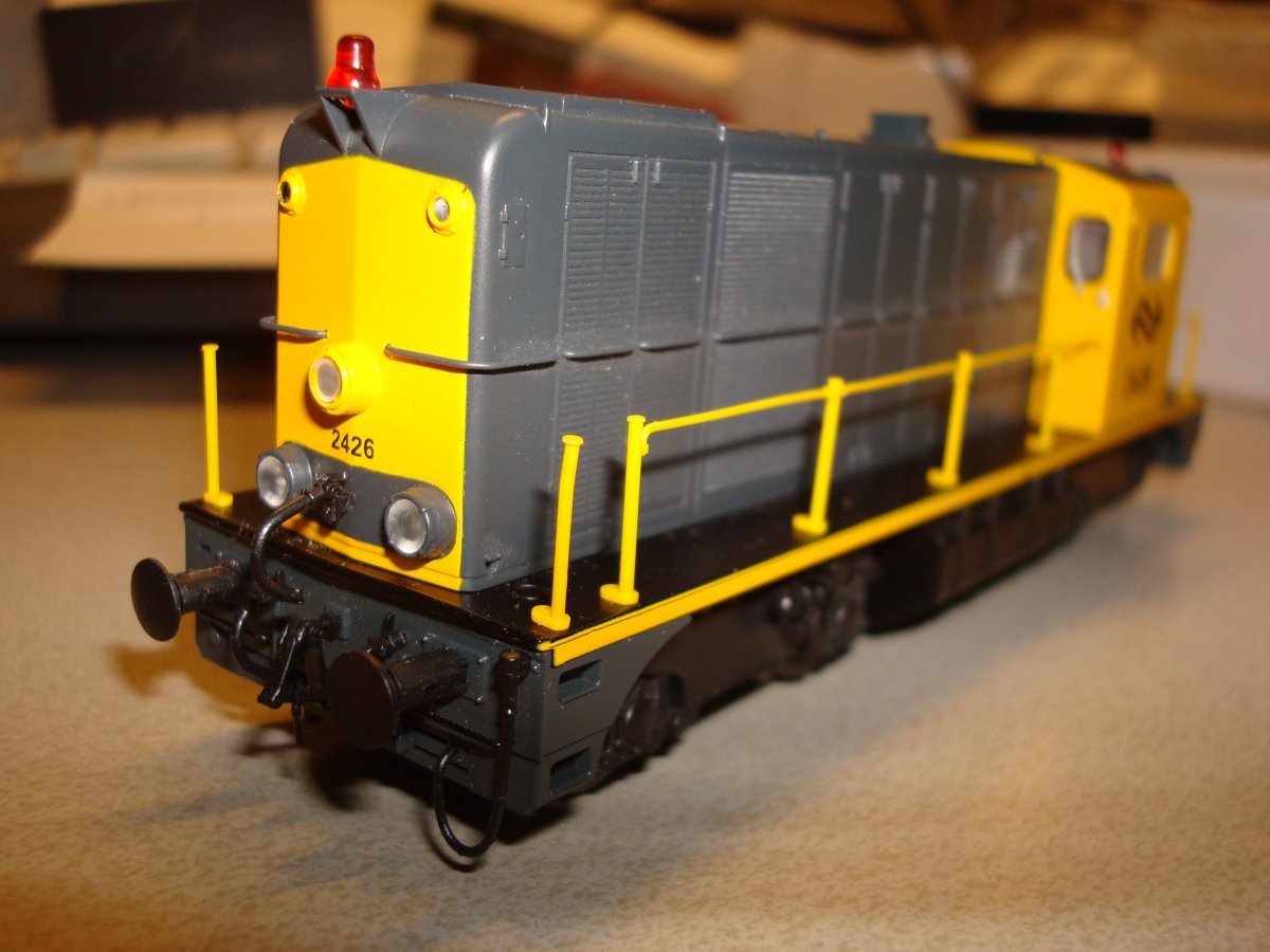

om dit topic toch maar een goed slot te geven even de afsluiting van het geheel:
na een week of wat wachten eindelijk antwoord van Roco:
thank you for your feedback-email and your patience! The investigation wasn´t
easy at all: The loco types NS 2400 were produced about 10 years ago in China.
Then/there socalled production lists were not used. According all logical
thoughts only two frames were produced as spare parts:
123179 RAL9005 Jet black
126164 RAL7037 Dusty Grey,
both with the few holes for the short lateral fences. The more holes must be
drilled for the long fences then. A separate spare part number was never
created for the more-holes-frames until now.
In context with the planned 70789 (news 2020!)....
[1]https://www.roco.cc/de/product/245033-70789-0-0-0-0-0-002003-1/products.html
.... you/we have the chance for a new frame for the long fences or the rework
of your frame by drilling
more holes at the beginning of second quarter 2020. May we ask you, to turn to
us again then (a private
drilling seems to be not reasonable in our opinion)?
Kind regards
________________________________________________________________________________
After Sales Department
Roco Customer Service
nou ja, ik had in iedergeval antwoord
inmiddels had ook Chris zich in de discussie gemoeid en hij bood mij het juiste frame aan!
door de vakantie etc heeft het even geduurd voordat ie hier was maar vandaag was ie er dan eindelijk
Dank je wel Chris!! uiteraard moest ie meteen in elkaar geknutseld:
al met al is het dan toch nog goed gekomen.
Groetjes, Ferenc
