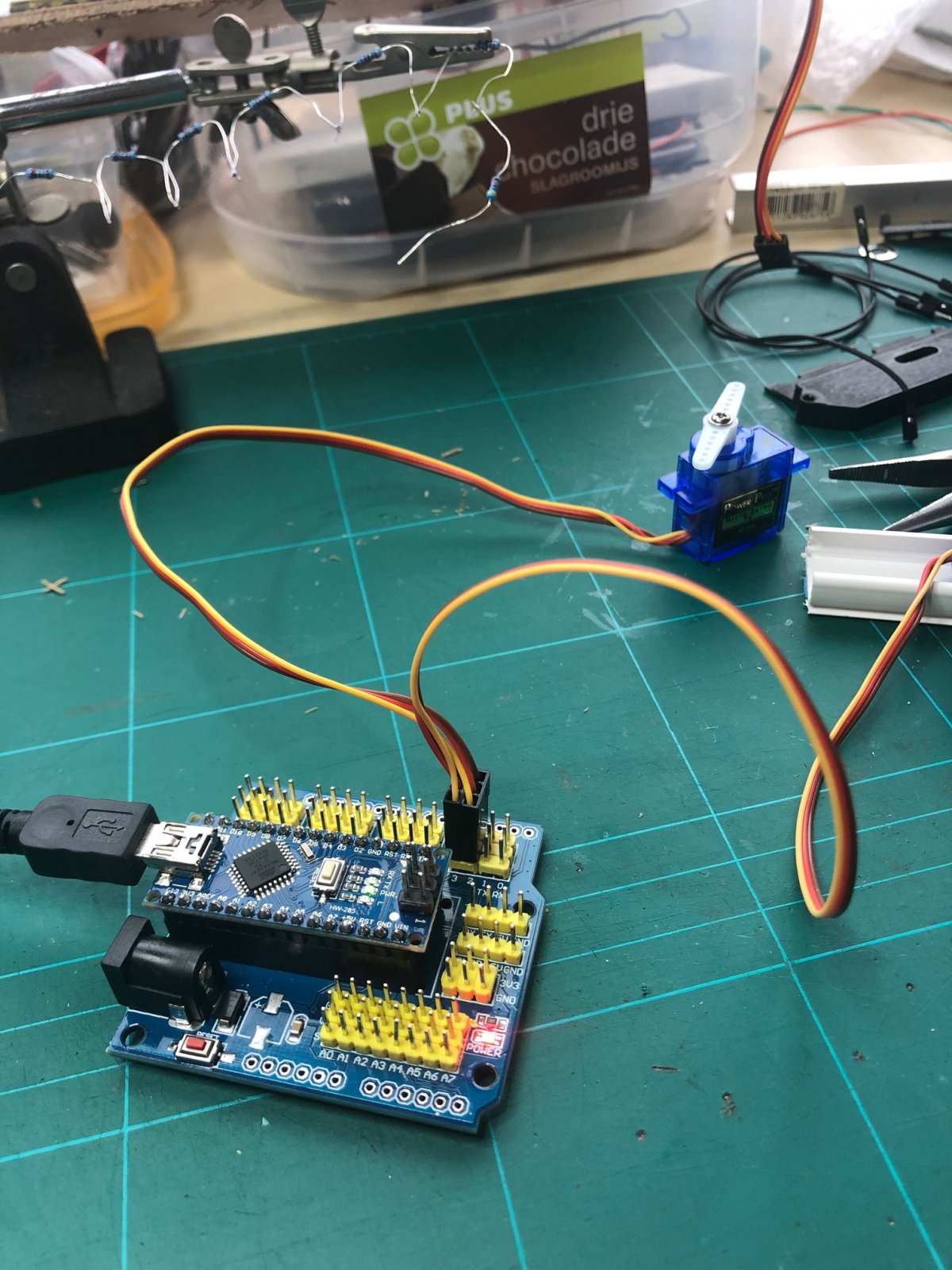

Hallo Bas,
Ben ik weer.
Ik krijg foutmeldingen wanneer ik de code compileer.
Compiling sketch...
"C:\\Program Files (x86)\\Arduino\\hardware\\tools\\avr/bin/avr-g++" -c -g -Os -std=gnu++11
-fpermissive -fno-exceptions -ffunction-sections -fdata-sections -fno-threadsafe-statics
-Wno-error=narrowing -MMD -flto -mmcu=atmega328p -DF_CPU=16000000L
-DARDUINO=10813 -DARDUINO_AVR_UNO -DARDUINO_ARCH_AVR
"-IC:\\Program Files (x86)\\Arduino\\hardware\\arduino\\avr\\cores\\arduino"
"-IC:\\Program Files (x86)\\Arduino\\hardware\\arduino\\avr\\variants\\standard"
"-IC:\\Program Files (x86)\\Arduino\\libraries\\Servo\\src"
"C:\\Users\\Ron\\AppData\\Local\\Temp\\arduino_build_636335\\sketch\\servoSweep.cpp.cpp"
-o "C:\\Users\\Ron\\AppData\\Local\\Temp\\arduino_build_636335\\sketch\\servoSweep.cpp.cpp.o"
servoSweep.cpp:74:6: error: prototype for 'void ServoSweep::setState(uint8_t)' does not match any in class 'ServoSweep'
 void ServoSweep::setState( uint8_t _state ) {
In file included from C:\Users\Ron\stack\_Ron\Modeltrein\Arduino\_Voorbeelden\NewServo+Library\servoSweep.cpp:8:0:
C:\Users\Ron\AppData\Local\Temp\arduino_build_636335\sketch\ServoSweep.h:10:10: error: candidate is: void ServoSweep::setState(bool)
     void setState( bool _state );
In file included from C:\Users\Ron\stack\_Ron\Modeltrein\Arduino\_Voorbeelden\NewServo+Library\NewServo+Library.ino:1:0:
C:\Users\Ron\AppData\Local\Temp\arduino_build_636335\sketch\ServoSweep.h:4:7: error: redefinition of 'class ServoSweep'
 class ServoSweep {
C:\Users\Ron\AppData\Local\Temp\arduino_build_636335\sketch\ServoSweep.h:4:7: note:
previous definition of 'class ServoSweep'
 class ServoSweep {
Using library Servo at version 1.1.6 in folder: C:\Program Files (x86)\Arduino\libraries\Servo
exit status 1
Geen idee waar ik het zoeken moet.
mvg Ron

  • Berichten: 5250
Re: Arcomora en mijn begrip van Arduino
« Reactie #18 Gepost op: 29 August 2020, 21:37:15 »
Sorry ik zie de fout, ik zou zwerend at ik hem al opgelost had.
De compiler zegt dat hij de functie setState met uint8_t als argument niet kan vinden. Dat is correct omdat er in de header file (.h bestand) staat:
Dat moet worden:
void setState( uint8_t _state );
Ik heb als het goed is de library op de github pagina aangepast. Excuses alweer  ::)
Een fijne avond,
P.S. Je post heeft deze pagina gesloopt  ;D. Als je een te lange regel plaats tussen de code blocks dan krijg je dus fenomeen
« Laatst bewerkt op: 29 August 2020, 21:42:37 door bask185 »

ron.kraaijkamp
  • Berichten: 272
    • Mijn baan in opbouw op 2RSweb
« Reactie #19 Gepost op: 30 August 2020, 11:43:32 »
Goedendag Bas,
Ik heb de code kunnen compileren. Tenminste, nadat ik mijn directory en INo file name had veranderd. Er zat een + in. Windows kan daar tegen, de compiler niet.
Moet regel 16 ook n iet veranderd worden van
bool state ;in
uint8_t state ;?
Verder initialiseerd de Arduino wel. De servo draait eerst als een gek tegen het einde van het draaimoment aan, om daarna de juiste positie te kiezen.
Als ik het goed begrijp moet je dus een 1 (5v) of een 0 (0V) aanbieden op pin 12. Dat doet nu nog niets.
Vandaag eens kijken of ik e.e.a. aan de praat kan kriigen.
Bedankt voor je input.
mvg Ron
« Laatst bewerkt op: 30 August 2020, 11:48:08 door ron.kraaijkamp »
ron.kraaijkamp
  • Berichten: 272
« Reactie #20 Gepost op: 30 August 2020, 12:04:56 »
Nu voor servoPin 4 genomen, dan gaat de servo niet zo tekeer.
Op 13 zit ook de LED van het board. En die zie je een paar keer knipperen bij het versturen van de gecompileerde code.
  pinMode(inputButton, INPUT);toegevoegd om pin 12 als input te definieren. Niet dat het wat uitmaakt.
Ik zoek verder.
ron.kraaijkamp
  • Berichten: 272
« Reactie #21 Gepost op: 30 August 2020, 12:45:24 »
Mijn input werkt nu. Voor de duidelijkheid stuur ik de status naar de seriele monitor.
Afhankelijk van waar ik de inputButton (12) aansluit, zie ik bij 5V een 1 verschijnen. En biji 0V een nul.
De servo doet (nog) niets.
Op naar de volgende stap.

Ik heb nu
pinMode(inputButton, INPUT_PULLUP);
en dat is nog eenvoudiger dan een pull up weerstand.
  • Berichten: 5250
« Reactie #25 Gepost op: 30 August 2020, 16:30:34 »
Ok nu ben ik het zat  >:(! Ik heb de oscilloscope gepakt om te kijken wat er nu misgaat.
Ik heb niet 1 maar wel 2 dingen ontdekt die niet klopten. In de sweep library gebruikte ik een private Servo object om de motor mee aan te sturen vanuit de library. Ik weet nog niet waarom maar dat werkt niet om een of andere duistere reden.
Ik had ook een fout gemaakt met een lokale variabele (currentTime) in de sweep method zelf. Ik heb deze variabele verwijdert en vervangen naar een call naar millis().
Ik heb de libraries op de github aangepast die moet je opnieuw downloaden. Ze werken nu ook iets anders
Dit wordt de nieuwe sketch:
#include "ServoSweep.h"
#include "Servo.h"
const int interval = 3000 ;
const int servoPin1 = 2 ;
const int servoPin2 = 3 ;
Servo servoMotor1 ;
Servo servoMotor2 ;
//                       min max speed frogJuicer pin
ServoSweep servoControl1( 10, 150, 50, 13) ;
ServoSweep servoControl2( 9,  150, 10, 12) ;
void setup() {
    Serial.begin( 115200 ) ;
    Serial.println(" hello world ");
    servoMotor1.write( 90 ) ;
    servoMotor2.write( 90 ) ;
    servoMotor1.attach( 2 ) ;
    servoMotor2.attach( 3 ) ;
    delay(100);
void loop() {
    uint8_t servoPos ;
    servoPos = servoControl1.sweep();
    if( servoPos ) {
        servoMotor1.write( servoPos ) ;
        Serial.println( servoPos ) ;
    servoPos = servoControl2.sweep();
    if( servoPos ) {
        servoMotor2.write( servoPos ) ;
    byte b = Serial.read() ;
    if( b == 'L') servoControl1.setState( 1 ) ;
    if( b == 'l') servoControl1.setState( 0 ) ;
    if( b == 'R') servoControl2.setState( 1 ) ;
    if( b == 'r') servoControl2.setState( 0 ) ;
Het verschil zit in de sweep functie zelf. Voorheen deed deze functie de servo aan sturen, althans ik wilde dat hij dat deed. Nu retourneert de functie de servo positie.  Als de geretourneerde waarde ongelijk is aan 0, dan moet de servo naar een nieuwe positie.
Met
Haal ik een eventuele nieuwe  positie op
En met
if( servoPos ) {
kijk ik of de waarde iets anders is dan 0. Zo ja, dan wordt de if statement uitgevoerd en wordt:
de motor aangestuurd.
Ik ben nog niet tevreden met hoe de code er uit zien. We kunnen de sweep objecten en servo objecten nog aan elkaar koppelen door middel van for-loops. Dat is fijn als je er meer dan 2 wilt aansturen. Ik meen dat je met een UNO 6 servo's tegelijk kan aansturen, als je er nog meer probeert dan gaat de millis() functie misschien raar doen.
Deze code werk wel... deze keer. 3 keer is immers scheepsrecht en ik kan ook maar zoveel fout doen  :laugh:

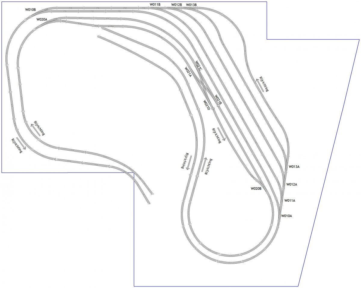

Dit wordt mijn schaduw station:
Inmiddels zijn de wissels W021* weggehaald. Zag er het nut niet van gezien het korte stuk aan de rechter onderzijde van die wissels.
Misschien heb ik er wel 3 nodig. De twee wissels links boven en die rechtsboven liggen zo'n 160 cm uit elkaar.
De meeste wissels zijn electrische. Behalve de twee link boven. Ik denk dat ik de elektrische verander in servo aangedreven modellen. Het is allemaal oud spul, dus kan met een gerust hart experimenteren. Of ik stuur ze toch elektrisch aan (met twee MOSFET printjes ertussen). Dat heb ik al werkend gekregen in mijn initiele code. Ik weet het nog niet. Met servo's werken is wel subtieler.

Dat heb ik ook getest aan de hand van de ASAR code. Je ziet op de foto nog een overblijfsel van de test. Werkt ook goed. Zou ik ook kunnen gebruiken.
Ik ben zelf gaan experimenteren om enig inzicht te krijgen in de materie. Daar moet ik nog aan werken, heb je wel gemerkt.
En eventueel dus elektrische wissels aan te sturen. Daar moet ik nog over denken.
