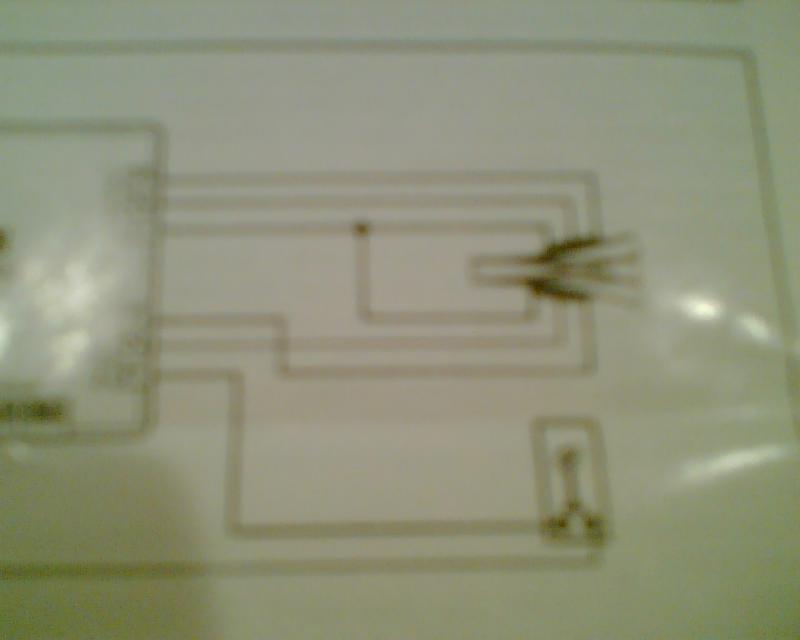

Ik probeer de handleiding op internet te vinden maar kan hem niet vinden dus ik hou me mond tot dat ik thuis de handleiding heb kunnen fotograferen

Dit is de text in de handleiding
Connection of three-way points to the receiver module.
The connection of a electric three-way point the receiver module is basically the same as connecting up straight-, curved- or double slips. As the three way points have two double points motors, then when connecting them up to the receiver module two outputs will be utilised. Correspondingly the point will take up two of the double square switches of the control pad of the central controller to set the points to "straight" as well as "left" and "right".
You should however, join the two light brown wires of the point motor which make the points change to "straight", and connect them to clip "1" on one of the two outputs allocated to the three-way point . The clip "1" of the other output remains free, and then to set the three-way points to "straight" only one of the two switches "|" set aside for the three-way point is needed
The remaining dark brown wires, which are the wires to switch the points "left" and "right" then go, one on each clip "3". Both black wires go to clip "2".
The way to connect the three-way points as described above has two advantages:
- Only one command is needed to change the point to "straight", because both motors are always switched together.
- One clip "1" remains free so that another electrical accessory can be connected into the receiver module (i.e. an electric uncoupler)
https://images.beneluxspoor.net/bnls/Afb073.jpg

En voordat iemand gaat zeggen dat is fleischmann magnetartikeldecoder dat klop maar ik heb ook viessmann 5212 dcc magnetartikeldecoders en daar werkt het net zo (ik ben namelijk mijn fleischmann dingen aan het vervangen voor viesmann decoders omdat ik alleen DCC nog wil doen)

Erik,
ik snap helemaal wat ze in dat verhaal zeggen. Maar ik vind het een beetje gezocht.
Als voordeel wordt genoemd dat je voor het rechtuit zetten nu maar 1 commando hoeft te geven. Maar volgens mij is dat een schijnvoordeel.
Kijk eens naar de schakelmogelijkheden die je hebt met een dubbele aandrijving:
     aandr.1   aandr.2
A   recht       recht
B   recht       krom
C   krom      recht
D   Krom      krom
De combinatie D, krom-krom, is een verboden stand. In die situatie zitten de tongen elkaar in de weg, dus in die stand zal het wissel nooit staan.
Als je dus naar de situatie A wilt kom je of uit situatie B of uit situatie C, en in beide gevallen hoef je maar 1 commando te geven, want 1 van de 2 staat al recht.
Wil je van B naar C of omgekeerd, dan moet je feitelijk altijd via situatie A omdat je anders in de verboden situatie D komt. Dus in die gevallen moet je 2 commandos geven. Maar dat is bij de oplossing die ze in de handleiding geven ook zo.
Dus, waar zit de winst?
Wim Ros

Klaas, dit is het zogenaamde voordeel,

Laten we het op houden dat we allemaal gelijk hadden
Het ging mij er om dat ik een keer een antwoord wist :)
En als ze in de handleiding zeggen sluit het zo aan dan sluit ik het zo aan oftwel bij twijfel sluit het zo aan als de handleiding zegt :)
Maar na jouw argumente gelezen te hebben ben ik het wel met je eens
Erik.

Wim,
Er is inderdaad een tweede voordeel dat je een uitgang over hebt.
En dat kan wel een echt voordeel zijn als je een toepassing hebt voor die aansluiting.
