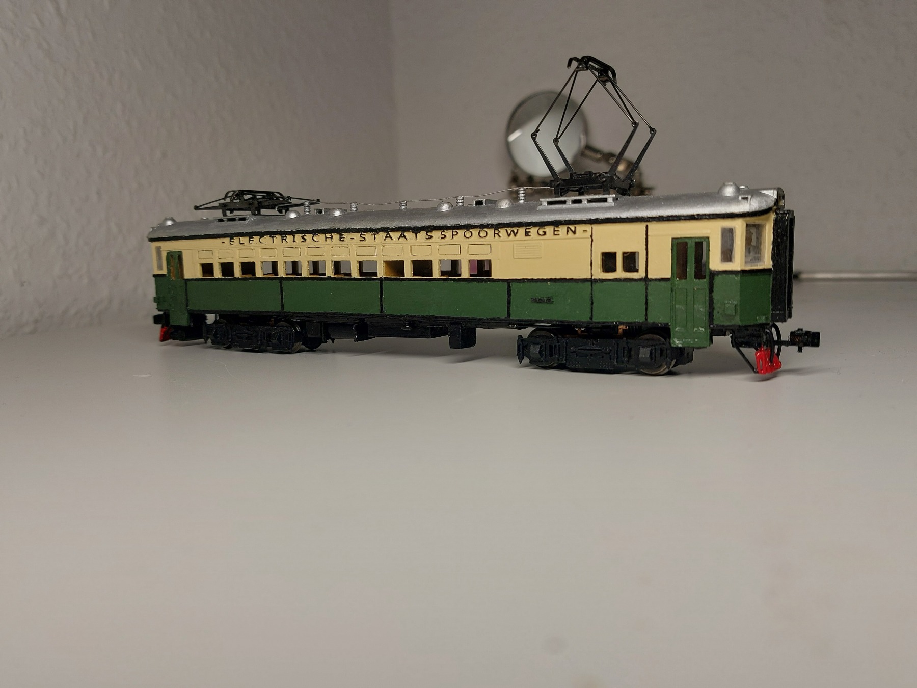

Hello,
I´m new to this forum and at the moment I build a series 300 electric rail car from Dutch East Indies, Jakarta formerly Batavia. I had two reasons to join:
1. I hope someone of you can help me to get more information about the rail cars and
2. I would like to improve my English skills in writing, because I am still in school and slowly approaching the exams.
But back to the rail car. I used:
- 2x Halling H0m bogies (28.7 mm axle distance)
- 2x 37.9mm cardan shafts
- 1x armature motor
- 2x photographs
- 2x Bachmann H0 EZ Mark II Knuckle couplers
colors:
- Revell 34, SM 314, MATT 88, 99
- Weinert RAL 9005
- MMC (Modellbahnmanufaktur Crottendorf ) RAL 6020
I printed the frame in a Filament- printer. The body was printed in a SLA- printer by a friend in two half's, because it was to long. I drew the hole thing with tinkercad in 1/87. Using a drawing (series 200) I found on the internet, a few pictures, videos and some creativity, I hope it will have the real H0- size. Maybe a few sidecars will follow next time.
Unfortunately I cant show you a picture, because I don´t know how to post it.
Bey, Java

Java
Berichten: 32
Re: ESS electric rail car H0m
20 August 2024, 16:59:46 »
Nu werkt het eindelijk, de spelling van de afbeelding was verkeerd. Pardon. De Indonesische Blokkendoz naast de Berlijnse S-Bahn (Lima) voor maatvergelijking.
